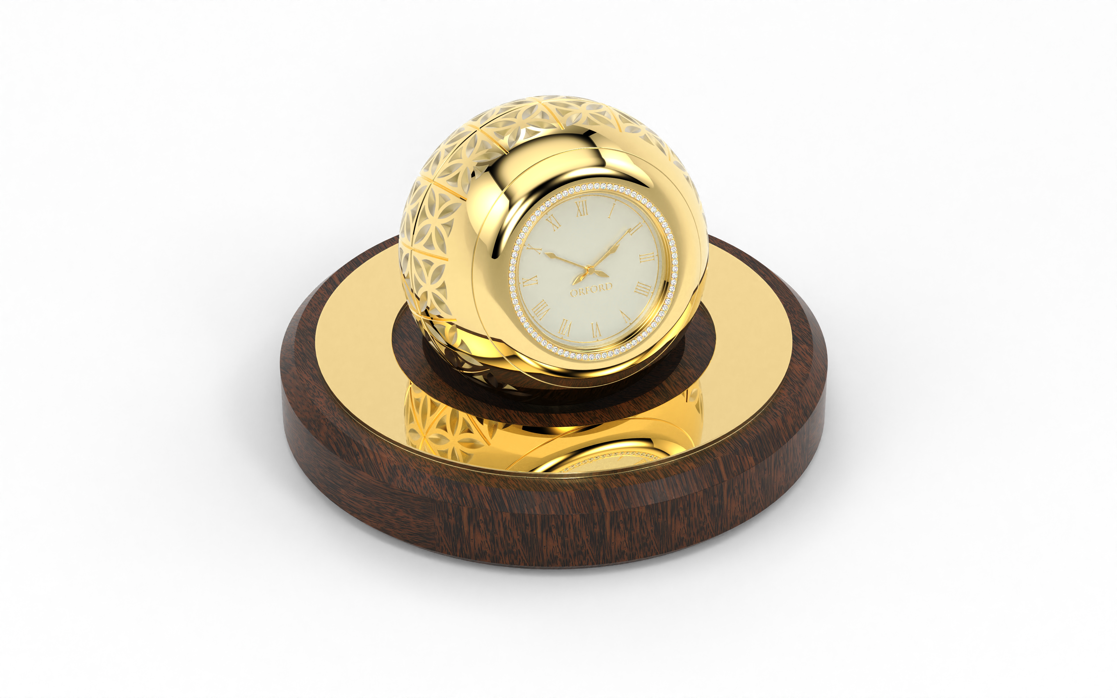

Hello again, new issue this time. Trying to make an animation of a ticking clock, but the quality of the animation is terrible. But the quality of a single rendered image is fine.
Single Image Render:
Animation Render of same file:

Is there something obvious I’m missing?
